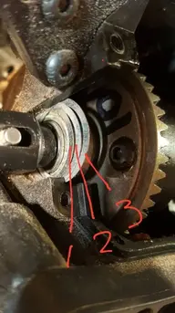

Shim it tighter, and your problems will go away. Are you replacing the ring gear as well as the pinion? They should always be replaced as a set.

Just bought some Tekno diff shims same spec. Just wondering if you always use 3 shims front and back. Was planning on trying 2-3 if fitment seems good on Kraton, Outcast, and son's Typhon after breaking front and rear main input gears.
The shims pictured above are also Tekno .1mm. Between friends we've got 8 Kratons/Talions in our local group. I've shimmed half of them, including my own two, and I now just default to 3 x .1mm shims front and rear. It starts out a little tight, but settles in nicely after a run.
Can you two me the size of the shim? There is a bunch the are .1mm and thank you everyone for the help!
