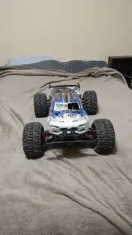

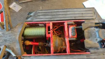

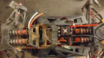

Hi all. So as the title states I have installed the Castle Creations Mamba Monster X esc/ motor combo. This combo is absolutely amazing and well worth the price!! I have installed the Arrma 17 tooth pinion gear as the 18T that came with the castle motor is the wrong pitch for the Arrma spur gear. Here are a few pictures and if anyone has any questions feel free to ask. It was a process but once I figured out how to mesh the pinion and spur gears, life got wayyy easier. That was the hardest part honestly. It is a wheelie machine, and even having the T-Bone racing V2 wheelie bar it will flip on its lid easily. I also installed the Thrasher front bumper and skip plate. Enjoy the pics.

If I was you I would put the combo in together.. I love my monster x combo. But I have noticed that with the Nero 17 tooth pinion gear it runs hot as hell. It actually goes into safe mode...
Im going to try the stock 15 tooth pinion and see how it goes.

I have the same setup in my nero. Took a lot of work, but worth it! I started out with the 2028 (beer can motor) bit it was way too much work to get it to fit. The 1515 is perfect. Enjoy it! Def. runs cooler than the stock configuration under the same loads.

I don't know about cooler. I think I need to change out the 17 tooth pinion gear and put back in the stock 15 tooth. I think it overheats the castle 1515. Especially with the body on, it has shut down on me twice and was hot as hell. I could feel the heat from the motor.
Really? Thats strange. I run a telemetry module on my 4px; and its for sure cooler than the BLX setup per all the data collected. I'm running a 17t as well.
Yeah I actually just found out that the warning beeps indicate the esc is overheating and going into safe mode. I have to call castle tomorrow and see what they recommend doing.
Nero with a 2200 Kv motor and 17t is way too much.
