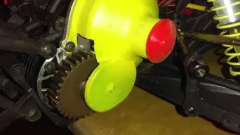

1458457383369-1945988096.jpg What's up guys! I have the upgraded blx diff and I made it solid plus I upgraded to mod1 gearing, now everything is steel works like a charm! Working on my cvd's broke a dogbone already! Hope this was helpful
Lor Fury 6S...what in the world is mod1 gearing and what are the advantages??? That thing looks beastly!
Also, try the HPI 6x83mm dogbones. They're a bit longer and beefier than the ARRMA stockers.
What's up! Csholcomb11 thanks for the reply, yeah the dogbones I need are soposto be shorter and about the mod1 that's 1/8 scale gearing or bigger the main gear that about almost 80% of Rc us is 48p then follows 32p and then mod1 that's what I'm running 34t and 36t 1700kv 6s. And the advantage of the mod1 is that I can deliver as much power transfer from motor to tranny with out worries of stripping the gears that's why I'm working on beefier cvd's. Since I locked the diff I know for a fact that the dogbones are next ahahaha! There's a pic of the different size pinions.
