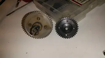

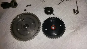

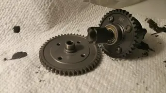

Tldr: it fits!
Longer- the only fit issue is the intigy spur is cut for a larger o-ring. Might need a thicker o-ring.

Yeeehaaa im ordering it now! Thanks for the confirmation Jerry. What pinion are you going to run first. Looking forward to hearing of your results!
With the 38t spur, I also got a 22t Arrma pinion. That will be the first run with this spur. From other speed run threads, I am guessing i will need closer to a 30t - 35t pinion to max out. But I want to start slow-ish. :)
First, though- I am putting the 50t back in. I still need belted tires before I try a speed run.
i don't know if it's just me but doesn't anyone realize that hole is a little too large for the typhon diff shaft?
Err... What diff shaft?
The only hole that is too big is the recess for the o-ring. The out drive shafts fit great. I'll double check for play tonight, but I remember it fitting nice.
