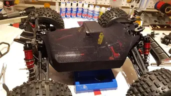

If your talking about mine, I run it through snow, slush, water, dirt and mud. What really helps is the panty hose custom cover I made.
