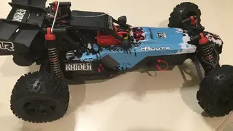

Here it is all stock:
Front shock support!
Aluminum skid plate
Steering is next. Ball ends coming.
Was a little bored and decided to give the wheels some color

Got the Traxxas Anocondas on some Arrma discs for the pavement. Didn't think I was gonna like the discs but they don't look half bad IMHO
View attachment 1897 Got the Traxxas Anocondas on some Arrma discs for the pavement. Didn't think I was gonna like the discs but they don't look half bad IMHO
Great grip with the Anacondas on the street but the rounded style of the tread pattern definitely gives it more body roll. (I will try to stiffen up the shocks) Overall, its been a great setup for the street though.
Very nice upgrades!! On mine I swapped the shock oil to 40wt/500cSt on all 4 and also put a ~3mm clip to pre-load the front springs and it helped significantly with body roll
Thanks. I actually just got some 40wt.... But I will have to try the bigger preload on the front.
I should've just bought the BLX cause this crazy addiction has me headed that way. Lol. Figured I'd make it stronger before I spring for the brushless setup.
I had similar thoughts (just buying BLX versions) but I end up replacing/upgrading so much (asides from what gets broken) over time, that I was happy to buy my Raider & Fury so cheap to start.. at least this way the ESC/Motor I've pulled to replace with BL wasn't already an expensive BL system, etc..
I hear you on the cheap to start. $150 is hard to beat. Plus, sometimes I think I enjoy the mechanic part of it more than the driving.
