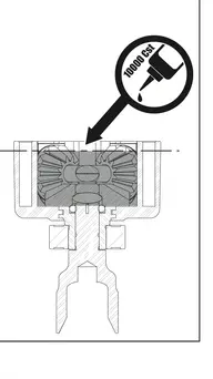

Wow I reckon you might be right it says 10k/100k/10k.

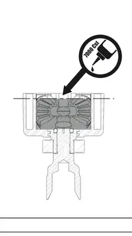

In the user manual it says 7k/10k/7k I wonder which one is right ????
Good pick up bro I might have downgraded my center diff oil.
That's center diff
That's front and rear
That's what's in the manual that comes wit the car

The manual is in CST, if I'm not mistaken 10000cst should be 100k WT. Diff oil is measured in CST and weight ( aka K)

The part that's confusing me is 7000cst vs 10k weight. So we need to find a good conversation table

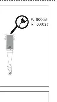

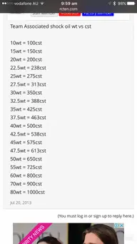

Shock oil is converted from weight to cst but diff oil is in k -thousands this is what the manual says for shock oil.
And this is the shock oil conversion chart ?

Just to chime in with my .02. Camo, if you did put 30K Diff Fluid in your center diff, then you did upgrade over stock. There was a comment made earlier, "Diff oil is measured in CST and weight ( aka K)". This is not entirely true. The letter "K" depicted is actually a unit of fraction, used to simplify measurement, where "w" is used for weight. For example, you could either label a differential oil as 100,000 or 100K. In that case, both would be CST. So if 30K oil was used, that would be 30,000 CST. Arrma is labeling all of their diagrams in CST, so the only conversion that needs to be made is for choosing the proper stock shock oil in weight. Which according the chart above, would be 60w (800 CST) in the front and about 46w (600 CST) in the rear.
OK but if you read the link I posted, in the manual arrma says the center diff has 10000cst. But on the outcast site they say it has 100k which would be 100000, so if it is indeed 100k then his 30k is a downgrade
