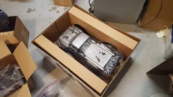

Outcast My Outcast will be here on Monday!!!

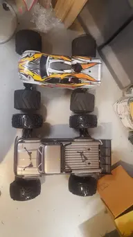

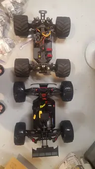

This thing is HUGE!!!!
Here are some pics comparing it to my monster 1/8 buggy DXR8E with RC4WD clod rumble tires and monster pirate wheels. Weight is similar to a std. Traxxas E-maxx but durability and power are up there. I've been tied up with Family activities but tomorrow, the power supply will cry when I start to charge my 4 6S battery packs. I've ordered more XT90 connectors so I can double up more of my hardcase 2S packs which will probably be my everyday bashing setup.

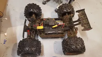

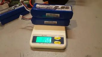

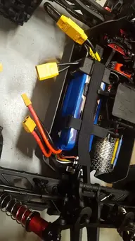

Truck is boring with 4S...this is my 6S setup using 2600 6S batteries in parallel for a combined 5200 6S pack they weigh about 800g. They fit well in the included battery box, they are a little bit narrower than a std. hardo case pack.
6S the truck is a blast to drive, will get on its lid if you have enough traction.

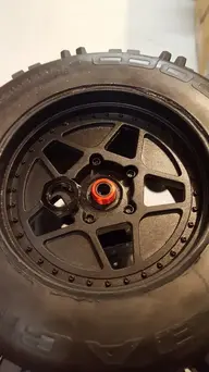

I have some Proline Big Joes that I wanted to put in but could not get the stock wheels off. take a look at how over-torqued this was at the factory!!!!! I'll be getting a puller from the autoparts store. This is a major quality issue here... 20161124_160834.jpg 20161124_191257.jpg 20161124_145407.jpg
Here is the 2/3 puller from oriellys this was a loaner so no cost to get. You still need to use force but this keeps tension in the wheel so it can back its way through the threads. The bad news is that it will scratch the red anodizing off the hubs.

I found my Outcast was running a little warm in my bashing spot with 6S POWER. Motor Temp was 170F and it was a pretty mild day in North Texas the upper 60's. I let it cool off before I finished the 5200 6S pack. My bashing spot has a little of everything... Hard dirt, short grass, jumps and lots of high speed sections. I was also doing alot of wheelies and all sort of stupid poop thst goes along with 24V of power ;)

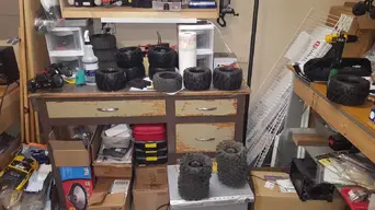

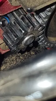

Now you will force me to count the teeth on the pinion gear...I do know the outcast lists the 16T pinion as "stock" . It does have a "speed" pinion in the spare parts bag. Duperbash is probably correct, I'll confirm tonight. The forecast for me is RAIN RAIN RAIN all weekend long...Let's just say the water proof system will be tested! What better way to let off some steam running 22V WOT! My tires found a piece of re-bar in my bashing spot, took a while to find the missing chunks of rubber tire... Some quality time with CA Glue...Now I'm on full on 3.8 tire BEAST MODE2. Using the locktite CA brand from Walmart. Seels to be workingood real good.

I had to put on my reading glasses to count mine, 16 came as extra "speed gear" with my goodie bag. I think Arrma gets worried about people being careless and burning these systems up with nonstop donuts or something stupid and sends trucks out geared small. Sorry you hit the rebar, stuff is brutal. Wondering if the wheels you're using are much heavier than stock, that extra rotational mass would definitely bring temps up a bit. Good thing for the mighty Walmart. Sometimes mine is a freak show, but prices are hard to beat.

R Duperbash you Sir are correct stock pinion is 12T, 16T is the optional "speed" pinion.

Hope yours wasn't completely over thread locked on. I had to heat the crap out of mine with heat gun prior before it would budge. Grub was difficult, pinion was loctite welded to motor shaft! Still wanting to message Arrma to chill out a bit with the thread locker and over torqued rig assembly. They should know customers like to wrench on and customize their stuff.
