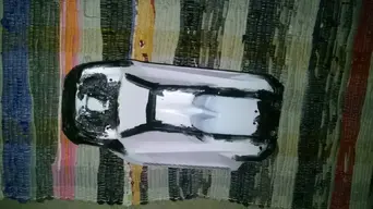

Tire glue plastic body washer inside an dry wall tape,shoe goo over to help hold. After drys 24 hour ,trim out material to match body holes, should hold up a while. Let you know by spring. Only put washers on rear holes, because they are the problem.
Check out my other body,have dry wall taped,an shoe goo also but with extra strips of lexan under it for extra strength in critical areas. This truck has been rolled, flipped end over,an cartwheeled. Body still holding up. 170 runs in it.
