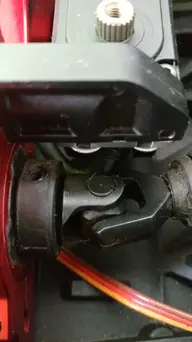

Got a spektrum s6230... Was opening it up to put in grease but noticed an o ring. There was nothing on the box or manual about being waterproof but a search online stated it was. One less step!
It is a very tight fit with the servo wire coming out the center.
See picture of how close the wire is to the driveshaft. Not sure if it will be a problem but doesn't appear to rub.
311 oz inch, moves the tires nice and quick! 118$ Canadian.

That 6230 Spektrum is one of my favorite high torque servos...and the 6240 is my favorite high speed one. So I definitely recommend them. Unfortunately I have an extra 6240 and not a 6230...was gonna put it in my Fazon too.
