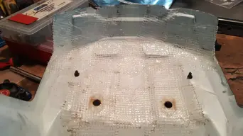

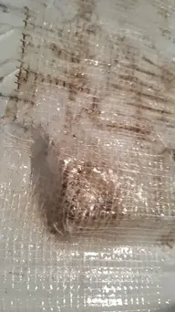

Also as a side note... the body i never run until.i have fiber taped and shoe gooed it at least a bit. With that being said this is the photos of round 2 body repair i did tape and goo it once before... the rear takes a beating unless you have a wheelie bar and that will help alot but landing on the lid will bust your top up quick... areas needing most attention are around the holes for mounting it... i had to rebuild one in the back almost completley i should have done this earlie realy no excuse seeing as my nero has been sitting waiting on rod ends there a bit ago i should have done it then...
