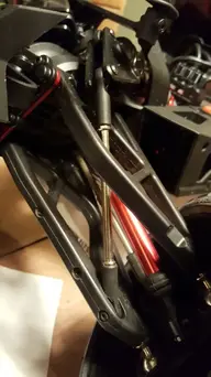

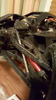

That's strange. All I can tell you is that it's different. The Nero rod ends are the same diameter as the end of the rods while the Fazon rod ends tapper out for a larger diameter.

@Cr3pitus mentioned using Associated pn 89077 to upgrade but I'm thinking that is for the upper that attaches to the cantilever. Probably a good upgrade to do but doesn't help with the lower rod end.
