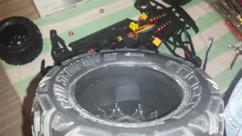

Do the Trencher 40 series with Tech 5 wheels fit on the Nero? Does the offset work?
I have extended hubs on mine as well. Would you happen to have a top down picture of it so I can see the clearance?

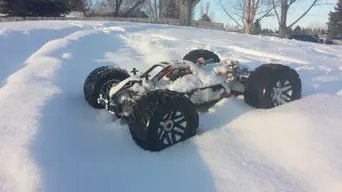

I'm digging this ride height! If you feel like sharing any details of your specific setup, cool. If not - cool too. :)
I changed out all the rod ends with RPM ends on the rods, traxxas ends on the shocks, using Hoboa shock spring cups, 30mm ext. hex gained about 1" of ground clearance, no bind suspension, everything clears, no rubing.
Tim have you notice a decrease in handling from the increase ride height? Does the truck still corner ok? Is it rolling over more often? Thx
What wheels are you running? Looks like 1/2" offset. Been thinking of putting swampers on my Nero but wandered if the money was worth it. Still running stockers.
I haven't gotten to run it since I did the suspension Mods. It should be ok, its 19" wide with the offset wheels
I run extensions from the Team Redcat 6s
