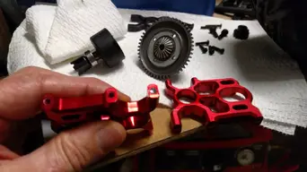

Just added 4th Arrma to family, bash hard 6s only geared up, going to try 100/200/50k any quick thoughts before I pour. Is this overkill, do like to drift, wheelie, and push from back somewhat. Sorry if this is beating a dead horse. Here's a pic of my Typhon borrowed motor mount compliments of stripped mount screw I ultimately had to drill through, no damage to chassis, but can't seem to get rest of screw out of mount. Gotta love stubborn thread lock!

Thread lock on Arrma vehicles is killing me. Trying to remove main input gear from the input shaft cup to swap bearings in the rear gearbox was almost impossible. I was almost to the point of having to just order a new gear box, input gear and cup. I was finally able to hammer it out luckily with no damage.

It really is too bad they basically super glue these rigs together. My first run with Kraton tried 50/200/7 and it seemed OK, was fishtailing a lot but was jump bashing in bark and leaf loose terrain. Loaded vids in Media, my daughter threw a beat down driving the Outcast for the first time off the ramp! Stopped by dirt jump park today but it was muddy with deep puddles next to jumps. Definitely going to do some big flips there when it dries some.

I know it's old post, but if you ever have trouble with stripped hex heads, grab a torx bit (star bit) just big enough to tap the torx head into the hex and it grabbing better and giving more teeth to work with. Just put pressure on awhile unscrewing. Used Gorilla glue and spare hex tools, no luck, so I used the it and no longer have problems getting. Again Torx star bits. I let the have worked great for me
