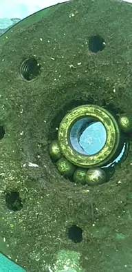

I also have an Arrma Nero big rock and after I used couple of times with 6s the motor seized. I opened it and found out that the front bearing was missing more than half of it's balls and the rotor was badly damaged. If they don't give me another one because it is still under warranty I was thinking of putting a Leopard 4282 V2 1680kv but I am confused because in the specs it indicates that the motor is 100amps but the don't mention the max volts and watts so I am not sure if I can keep my original esc BLX 200 150 amps. Another option I thought that the Rocket motor 4076 1720kv seems quite good and they both can be opened to clean and replace bearings or rotor not like the original one because it was sealed.
