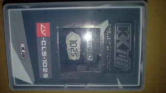

To be honest I've heard the electronics arrma use ain't the best..I upgraded the servo in my typhon with a cheap power HD 20kg waterproof one and it was a big improvement it's made my outcast feel docile to the point I ain't using it til I gt the new servo in the..so I think il upgrade esc soon hopefully il get the same outcome with difference in performance
What servo did you pick up?
The one I mentioned in the post I got it from a Ali express bang good also sell it my other one I ain't used yet is also from Ali express spec in files
