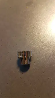

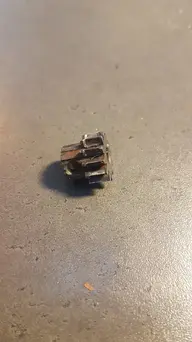

All my pinion gears, stock and robinson racing look like this after a few runs, they stay like this and nothing breaks but is this normal or is maybe my spur gear causing this?

I am using the stock pinion none of my gears look like that. I know you bash it, but that looks excessive. Maybe the mesh is too tight, or even worse, at a slight angle.
Yes, that's due to the tolerance between the gears being incorrect.
I have found that inserting a piece of paper between the two gears then adjusting has been the best way to find the correct tolerance. I check my tolerance after every run and have found no issues due to wear.
Hope this helps
Also give the gears a good clean after each run to remove any debris like sand, dirt and mud will also prolong the life of the gears.
You cant just make judgement on one specific situation, in this case based on your rc alone. There is another user on this forum and myself that both had premature failure of the pinion gear.
I submitted my claim through Hobbico and was sent another brand pinion gear because they are way back ordered on them, and thats for a reason.
I checked in between and after run plenty of times. Besides cleaning up, to make them last longer let them cool off, or help out by spraying every now and then a little wd40, or light silicone oil. Metal to metal gets extremely hot, and the hotter the weaker the teeth get. One cannot rule out a possible pebble, debris that allocated there and it takes seconds to shred through.
Srrange as it may seem if one really bashing, and not paying attention, it can go unnoticed missing 2 teeth, and before you know it they are all gone.
