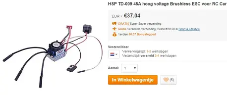

i am maybe the second one .....only on how many reg.bls users?
if youre ref. is this site ... it is still ten procent?
searching the internet looks like many do not use the original esc any more..
does this fit?
It is hard to say how many percent do encounter problems with their BLS.
And besides this forum there are at least 3 other fora where people post their experiences with their Arrma's.
You could buy a new esc. And indeed the one you link from a Dutch webshop might work.
I do not know this particular esc
But I do know the brand.
Since hobbyking has good products too I will never say this one might be bad. Could be a cheap third party option!
