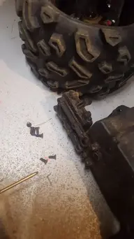

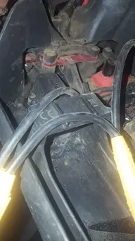

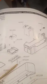

Here are some picures I took when I replaced the 8mm screws with the correct 5mm ones. You have to open the recei'ver box,simply pull out the receiver, you can leave the wires attached. Then you remove 6 countersunk screws from the bottom for the battery box. The whole thing will come out with the bottom of the radio box attached.
Those (2) screws came out of the front of the battery box where they dig into the pack. Here is a picture of the correct length screws next to the 8mm ones
After you replace the screws the battery box should look like this.
No more screws digging into your batteries.

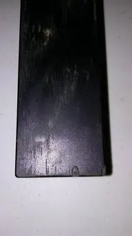

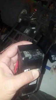

Here is some damage from my softcase 6S lipo from those dam screws!
Looks familiar? My other packs probably have same type of damage.

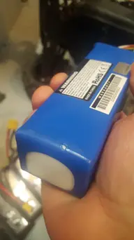

I've noticed this with my out cast..noticed a a bit of damage on my lipo checked my battery case and could see some thread sticking through so I've covered it with gorilla tape. Think it's done the trick..will look into getting the 5mm screw's at some point
