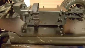

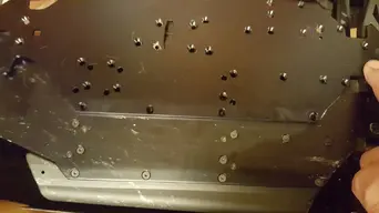

Well...leave it to that 1%....it actually won't fit unless you drill some new holes. The new battery box is shorter so the rear holes are an inch towards the center. I took 2 photos. First is the tray against the bottom of the Kraton with the front of the battery tray lined up and the second is the chassis of the Outcast vs the chassis of the Kraton showing you the new holes.

I'm sorry that it did not work. I was planning on getting that battery box for my senton and typhon but now debating if I want to get them and try it or not.
Well I have both the Senton and Typhon and you will have the same issue. To switch to the new battery tray you would have to drill new holes or get an Outcast chassis .

whats weird is the new 2018 kraton chassis and old kraton chassis are the same part number, and the outcast battery try has the same part number as the new kraton battery tray how does that work unless the new kraton chassis have same part number with new mounting holes for battery tray.
I bought an Kraton v2 when they went on sale to get rid of stock for the v3. My v2 has the holes already on the chassis for the outcast battery tray. It must have been an updated chassis right before the v3 came out. The last of the v2 must have the v3 chassis. My only guess. I know a couple others who have a late v2 and they have the holes already in the chassis also.
Here is a pic....
ya my chassis doesn't have those holes so your theory has to be right. thanks for the pic.
Your welcome, ive heard of people drilling holes to get them to fit. doesn't seem like it would be a big project. Just a couple holes. Hope it works for you...
Yep. I installed an outcast battery tray in my v2 without any problems. Straight swap. I guess its a V2.1 now...
