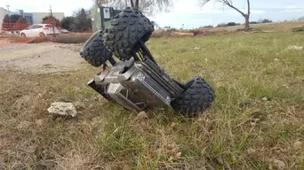

Another beat down as R.Duperbash calls it The outcast has been impaled by a re-bar sticking out of the ground...my boy thought he had killed it. Then I'm blasting away with wheelies do a wicked jump on the grass and it tumbles like 8 times. Outcast is unresponsive. I'm thinking I finally killed it...
The hit was so hard the on/off button switched itself off. Either that or the truck wanted a break. Turned it back on and the beating continued.
Latter when I was taking the battery out I noticed the blue wire to the motor was almost completely off. So folks after a real hard hit take a quick look at the motor bullet connectors make sure they are in all the way.

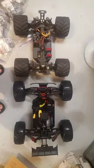

I've never been able to run back-to-back packs through the truck, the motor can empty a 5000 4S lipo without rest, but I had to stop half-way through the 6S. WOT on grass really heats up the motor. A little fan goes a long way in these motors. I just zip-tie the fan direct to the motor can.
The truck on top has an extra long 36mm can so I just used (2) clip on motor/fan heatsinks. With larger diameter motors or the ones with fins, I just ditch the heatsink and wire-tie the fan straight to the can.
