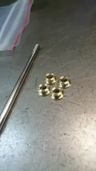

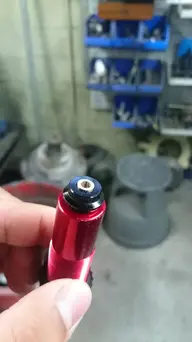

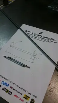

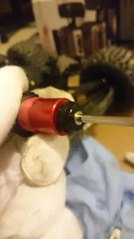

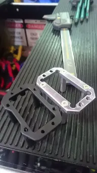

G'day fellas, a little bit about my build. Love launching the thing in the air, but I start to worry about its landing capabilities and weak points during touch down. Here's just afew things that I've done to help improve its performance.
Custom made bits: aluminium servo mount, aluminium shock pistons, aluminium rear skid plate, and industrial 90mm 12lb/in front, 100mm 10lb/in rears springs. (double spring rate of tekno orange)
Standard upgrades: 50k/300k/30k diff oils, 1200cst/1300cst shock oils, 20kg savox servo
Future upgrades: tbone bumper, rear mud flaps, and fab more aluminium shiny bits
Stay tuned for some more big air videos
Enjoy!
