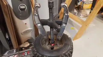

You guys having fin with the motor pinion. Wait untilist you need to remove a wheel? Here is a picture of a contraption I assembled out of a gear puller from oriellys.

It does get frustrating, makes me ask myself "am I doing something wrong here" no it's just gobs of thread lock and very tight tolerances. My motor mount is also fairly knicked up now, but did getterdun.

I learned a while back to use a soldering tip to heat up the screw heads on these RTR builds. I even used a small soldering torch on the motor mount screws, that's what it took to heat the locktite enough to get it to easily remove the screws.

Nitroman you are so right. I did that with my Typhons, but was tired and didn't think to use iron on motor mount screws with the Outcast, would have been much easier on the car and my wrists. Working smarter is better than working harder.

Once you get the wheels off remove some material from inside the hub where the screw goes through. I used a small drum sander. I've read some people use a sharp exacto knife.

Sharp modelling knife is exactly how I did it. Why they can't do it in the factory I don't know.
