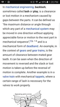

Gear backlash/mesh same thing. I've been outside of the RC world too long.

Just to show I'm not making things up lol
