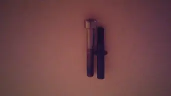

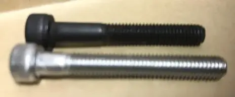

Honest real life testing and abuse....Will keep this short but ROCKER POST breakages can be eliminated using these inexpensive parts ......attached pictures
1..... replace with M5 X 35 hardened cap bolt...original arrma rocker is M5x32...tighten snugly then slightly back it off and check bearing for binding...(best to do with shocks removed).bolt is solid ,not hollow and stronger than the .stainless steel bolt modification..(The traxxas 5145 mod worked similar but required tapping)

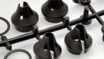

3.....Install hobao shock cups....The original arrma cup slams the rocker and these eliminate issue

failed to mention bolt is avail. at home depot or other and the silver bolt is the original stainles 10/32 mod that has been discussed

Are you referring to these?
Tower Stock# L5GJLD02
Manufacturer Stock# 90049
Can be found here. But it's only the spring perch. Are you looking for the shock absorbers as well?

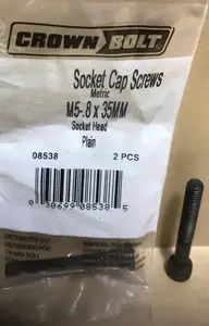

So the bolt that came out of my rocker post on my big rock is like 12mm long. There's no way a 35mm bolt is going in there. What am I missing?
Edit: figured it out. Remove the whole stock rocker post.
I just put some in mine...get some #8 stainless flat washers. Two on the bottoms one on top and snug down until rocker gets a bind and back off until there's no binding...goodbye to broken post bolts. M5x35mm

Don't get the stainless steel!!! They bend
I didn't need washers. The factory bolt and rocker post had no washers. I don't think there will be any issues with the bearings with just the bolt.
Correct.. just check the rocker for binding.. is little free play is ok
