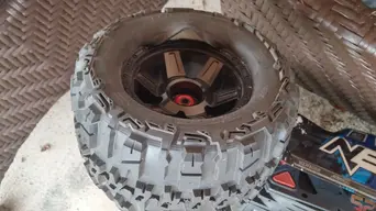

Just put Pro Line Trenchers on and first run one of them came unglued...they balloon worst than the stock ones...

If I may ask, other than an increased risk of shredding, what's the big problem with ballooning? Total noob question, but curious ;)
I'm getting ready to run my SMC 7200mah 90c lipos and that's just too much ballooning for my taste..

I'm a noob too, but like the man said..... 70MPH on dinner plates....The handling suffers terribly. And at some point the rubber will reach it's breaking point and the tire will tear apart. On the other side of this, and there are limits to this, but ballooning tires make it go faster. Larger circumference = longer footprint for one rotation = travel further for 1 rotation of the wheel. When I first put on the Terrain Crushers I was disappointed at the speed loss, but WOW with the handling. Ballooning tires will also help the car flip, while airborne. The gyroscopic force of the tires is what flips it,. There is more gyro force created with a set of ballooning stocks that there is on a set of Terra crushers.

They balloon just like a Top Fuel..and it's like having overdrive..

I think ballooning is a preference and driving style based thing. Some ppl like it, some don't. No one would recommend - really any of the ProLine 40 series tires for speed runs - they are -great- offroad & bashing tires though. The X's have wicked traction - I have more diff issues when I run them than other tires I have o_O. Turning radius difference is partly due to the offset of the wheel vs stock wheel - not really the tires fault. Add to that the increased traction (vs stock) you end up with the rear hooking up more and taking weight off the front end further impacting the turn. I like the stock v1 tires for some stuff - just enough traction but just not enough to where you can get a nice power slide going (on asphalt) :)

It's throws the handling of the car right off. Imagine going 70kmph+ on dinner plates lmfao
