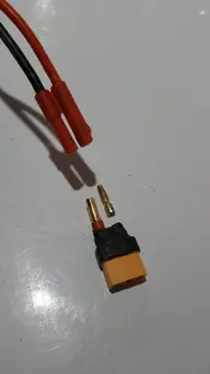

I ordered this connector from ebay (http://www.ebay.com/itm/HXT-4MM-Bul...583a7ad&pid=100005&rk=1&rkt=6&sd=381877318596) and connected it to my lipo and plugged into the new 185 esc.
As soon as I plugged them in (2 x 3S Turnigy 4000mah lipo), the smoke came out of the connectors and puffed the lipos. I immediately removed the connectors but they were already melted.
I am fairly new to rc car and would like to know what I have done wrong. Did I buy the wrong connector?
Should I have bought this instead? (http://www.ebay.com/itm/DIRECT-CONN...18596?hash=item58e9a973c4:g:ziMAAOSw4GVYSKzn(
The lipo batteries are puffed so I don't want to use them anymore (too risky I guess) but what about the new 185 esc? Is it dead? =(
Please advise.

@RcDriver consider yourself lucky to even be posting this. LiPo fires can be severe.
To keep this short as possible, yes you ordered the wrong adapter and you should have picked this up just by looking at the second photo you've attached. Black goes with black and red with red. Your second photo shows red with black and black with red.
This is just one reason why I don't encourage the use of adapters. Make it easy on yourself and in this case MUCH safer and just buy a some XT90 connectors they are really cheap and easy to do.
Everyone, new and old to the hobby, needs to understand what they are dealing with when messing around with LiPo's. Many of us just drool over the power LiPo gives us over other types of batteries and while that is great and all - LiPo batteries can be dangerous if not handled with care. Do we need to be reminded of the exploding Samsung Note 7?
Going back to your questions - yes the puffed LiPo's are toast and not worth risking. Consider this the cost of learning. Get new batteries, either with the XT90 pre-installed or install them yourself (skip the adapter). Then test the ESC, you've got a 50/50 chance it's dead as well.

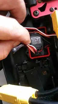

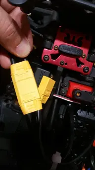

20170319_100047.webp Thanks everyone for their comments.
I have been busy lately and finally found a time to play with senton yesterday. I bought 6s SMC lipo (with xt90 connector on it!!) and fully charged it.
I plugged in the xt90 loop connector on one side of esc connector and connected the SMC lipo to the other connector.
The esc smoked again......this is the 2nd esc I fried. What did I do wrong this time.....?? This is very frustrating.
Please let me know if you need more info or pics
