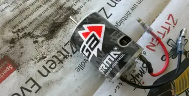

Stock motor vs. brake
The reason you do not have good braking power is because of the stock motor:
Above is mine after just two lipo packs 2S.
The black powder was before these packs one of the brushes....
I had an old, but fairly good (for a brushed motor) motor, which I popped in instead:
This one has replaceable brushes, Neodymium magnets for more torque, and in despite being a 21T motor more RPM.
Instantly I had more speed, better torque and above all finally braking power.
On tarmac I could block both wheels easily, which was not possible with the stock motor.
Of course I would recommend to upgrade to brushless, but if you are on a budget...
