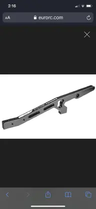

So now I’ve ordered up the 7075 center braces. These stock ones are made out of a less durable aluminum just like the kraton EXB’s were.
I also have the 7075 diff cups ordered and the Swiss 7075 drive cups.
