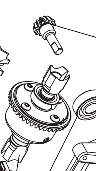

Also check if the noise is coming from the main input gear. If there is to much free play between input gear and the main gear when assembling it will be noisey.
Theyfore I asked for an disconnected motor.
Next step will be to check that the spur (main) gear is running round and the pinion (input) gear is running round of the spur gear.
Also the recommended play in-between them (thin peace of paper thickness 0,05-0,08mm max 0,1mm)
We will see what the answer after check the diff can tell us
