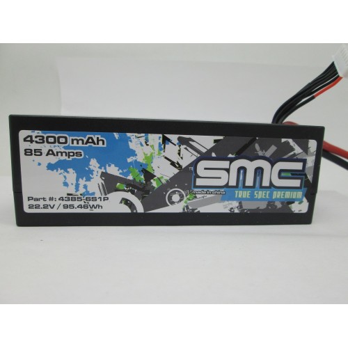

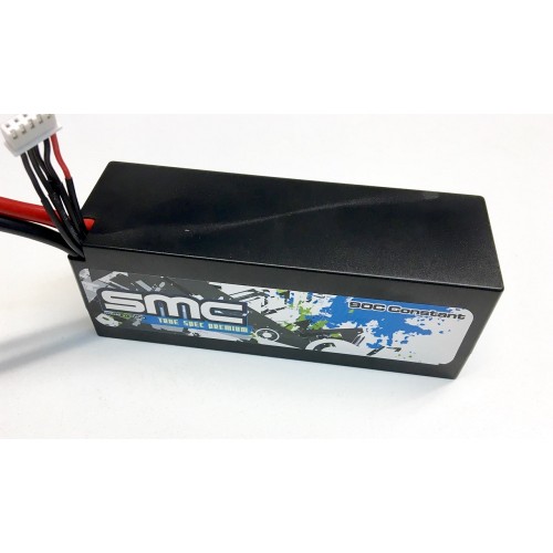

Just ordered two of these:
True Spec Premium 22.2V-4300mAh-85 Amps/90C pack Extended Capacity.
- Built with wide tab cells for lowest possible internal resistance.
- 10AWG wires soldered straight to the tabs.
True Spec Premium 22.2V 4300mAh 85Amps/90C Extended Capacity
  • Product Code: 4385-6S1P
  • Availability: In Stock
  • $99.95 $69.95

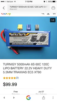

Anyone tried this turnigy 6s lipo in any of there Arrma vehicles?? Was thinking of trying it in my V2 Kraton
Awesome JvG thanks for info. My friend runs a 4s version in his Senton and it rips so was just curious on other people's experiences. Thanks again
I got the 4000mah version nice and light with heaps of grunt love it. The only one thing is the soft pack tends to get a bit knocked around in the Kraton battery tray
