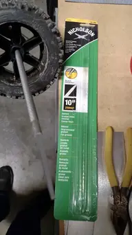

No. I had the same issue with 2nd set of Backflips, wheel hole is a tad smaller then stock Kraton wheel hole, go figure, the Outcast and Kraton have the same size hex's! Both of my sets had to be deburred with a rat tail file to fit on the hex's easily. Some used a Dremel, I'm old school used round file bought at Home depot after trying a body reamer to enlarge hole.View attachment 5372
Am I the only one that just uses a 1/2" drill bit to drill the holes larger after I get them off?
