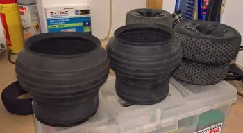

In Celsius that would be 150-160 degrees, which I did this afternoon:
I let them in for 15 minutes, as you suggested ;)
And indeed one side of the rim came of easily, without damage to both the tire and rim:
As you can see the other side was still bonded, without any sign of coming off.
Next I did the second set I have, same procedure.
And nothing let loose, even with applying a lot of force to it!
What went wrong?
Next I will test @WoodiE 's boiling trick.
By the way, have two blisters on my thumbs. First because I was foolish not to wear gloves :p
Secondly, there was so much sand in it. Sand keeps it's warmth quite well, so the tires stayed a long time bloody hot! :eek:
