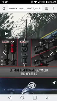

Is this really the case? The Big Rock uses the same part # for the rod ends as previously, and there's no visual difference on the site:
http://www.arrma-rc.com/part/AR340093
I'm serious. Here is a screen shot on the rod ends. And it also comes with the hd 14mm drive shafts along with the hd rod ends and bigger shock shafts. You have to scroll through the pictures to find it.

I think the big Rock used the new shock rod ends.... no rod end fix has came out yet... I will look into this more after I get up.

Ohhh if your talking about the push rod ends then no. My bad, I thought you were talking about the shock rod ends, as that is what most us are breaking on the Nero.
