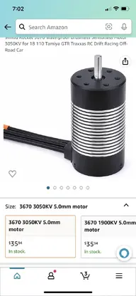

The vorteks 100a is a smart esc. So are the 120a off the new 4s line and my favorite, the 130a off the losi tenacity pro. You can get them off jennysrc.com for a reasonable price.
https://jennysrc.com/collections/lo...mite-smart-130a-fuze-brushless-firma-los03027
For the motor I like rocket or hobbystar 3670, 3050kv.
9imod Rocket 3670 Waterproof Brushless Sensorless Motor 3050KV for 18 110 Tamiya GTR Traxxas RC Drift Racing Off-Road Car https://a.co/d/c9QgIuy
