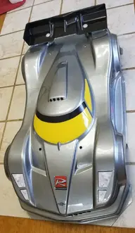

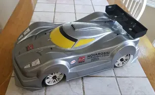

Here's my senton with a Delta plastik Toyota GT1 body....stock esc,motor,spur and 17t pinion....hits 57mph gps with a 50c 6s 5000mah ?
Been a while - I've got a delta plastic (damn autocorrect) body, bout half way through converting it. Need to get back at it. Were you having problems w/ the car flipping, or you just swapped anyhow?
