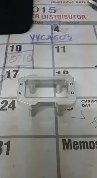

There is someone right now taking orders for custom machined aluminum mounts for the Arrma 1/8ths on the Arrma 1/8 group on fb. Things look perfect, I'll be ordering one.
You should tell said person about ArrmaForum.com, I bet he or she would get a few orders ;)

I will, he is getting the first batch of them in this week. Has the first couple prototypes and they look even better then that pic.

Hell ya!! That is nice and shell be copied :)
I am trying to start a new thread... I am the one making and selling these.
I am taking orders for the mount through my face book ..they will only come in aluminum.. But 100% paintable with a good paint
