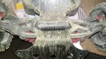

looks like my servo is done. Started clicking tonight while at skateboard park. Would turn one way but not other. So. What servo y'all putting in? Waiting on a TBone bumper also. Didn't realize till tonight it helps hold A arm pins in I bashed it pretty hard. So no complaints. Just need to get some more upgrades.
I recently installed a t bone bumper it's a good product but when the bumper hooks into the ground it pulls the pins out,which caused my typhon original bumper come off which then caused the a arm pins to extract which on 6's power has done something to my front diff.. have not investigated it yet
