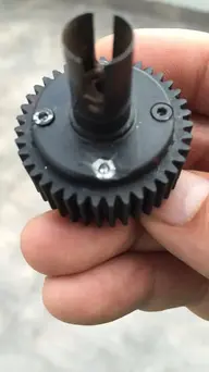

Hi, I just tried to open the diff without success. Three of four screws were stripped. I tried using a dremel but it could damage the cover. Have you deal with this situation, how did you solve it?.

Dam!
My diff came apart very smoothly. There were a lot of screws but, it all came out just fine.
I don't use regular hex wrenches. They tend to strip screws. I use star wrenches. I got mine from Home Depot. I would suggest slicing a thin notch all the way across the head of the screw and then use a flat head screwdriver to remove the screws.
Otherwise grinding them would be another option.
If you grind them you can use needle nose plires to remove the remainder of the screw.

You could try an EZout as well. You'd have to find a very small one, with a matching drill bit, but with the factory screws it should work.

Here is something you can try, it has worked for me a couple of times. Take and clean the screw holes with carb cleaner, then let dry, then get the right size allen wrench for the screw hole. Then put super glue into the striped out screw hole and then put the allen wrench into the hole and let the glue dry around the allen wrench. Then try to remove the screw, it's usually a one shot try.

Here´s an update. I give up!!! I just ordered a new diff. I did my second attempt trying to open the diff without success...mmm, I did reach the diff faster than the first time and get off three of four screws but couldn´t open it. Here´s a pic.
