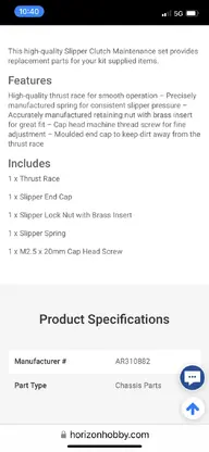

Does the screw just spin after a certain point? Could it be stripped? What length is the screw?
Maybe measure the screw to make sure it’s 20mm and inspect the threads to confirm it’s all solid.

The screw in the slipper clutch is the one I got from the first maintenance kit. The length is exactly the same as the one in the spare maintenance kit. I am genuinely stumped. I've watched 10 videos on rebuilding it and I'm doing everything right. The screw is catching on the black plastic piece on the other side but only if I do not have the spring in place. It's just odd. Not sure what to do now other than take the spring out, or cut it down a little and Loctite it and hope it'll be fine.
@Velodromed - going to trim the spring a little and see if that works. At least there will be some tension then. Checked the little black plastic pieces and the screw does connect when there is no spring. Also put the screw into each component part of the assembly and it isn’t threaded, it goes into and through each piece separately.
