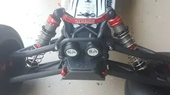

I am currently trying to source new aluminum racing shocks for my Raider Mega Brushed 1/10. The factory shocks are absolutely terrible and it is embarassing when i take it to the track to practice. I have upgraded it to brushless and that has given it the power that it needed but the suspension is what is letting it down. Can anyone recommend aftermarket brands that have aluminum shocks suitable for the Raider???
I am located in Sydney Australia and the hobby shop that i go to frequently for parts has been searching for 3 weeks for an aftermarket upgrade with no luck so i might have more chances of sourcing them myself with the help of this forum.
I have tried different viscocity oils in the factory shocks but now the shock tops just pop with a hard landing. And with the shocks measuring at 93mm rear and 76mm front I haven`t found anything to replace them with.
Hi
STRC makes aluminum upper & lower shock caps, and shock bodys to replace the stock plastic parts.
That is one option that i was considering but i was hoping to find full units ready to fit. My next step was to add more holes to the pistons to make the shocks travel alot easier and make them more responsive because when the car hits bumps the whole car moves instead of the shocks doing most of the work. The biggest problem is stability at the moment.
I too have gone brushless with my Raider Mega. I have upgraded the front steering knuckles and rear hub carriers with the STRC stuff, and it is good quality. The shocks are still on my wish list, but with the quality I see in the parts I've installed already, I don't think you'd be going wrong.
Although your modification on the pistons would be a much cheaper alternative if it works.
Let us know!!
Ok. So i have modified the pistons by adding an extra 2 holes of the same diameter and filled the shocks with a 35w oil and it has made a significant difference but i can`t test the car because the steering servo smoked itself yesterday. But i do have some info on some Traxxas suspension that is a direct fit to the Arrma Raider Mega. part numbers are #3760a Front, #3762a Rear suspension. I am doing some research now on those part numbers and i am liking what i see. plenty of aluminum racing options and various springs are also availible. Far greater quality and there is alot on the market.

Would the strc shocks work for the brushless xl blx? What are the lengths in mm of front/rear and are they Aluminum. If you have stock numbers too, that’d be great
Thanks cuzZy. Do they come fully assembled with aprings? What weight oil are tou uisng for each and sonthey come prefilled? Am looking to bash and do ahort reack type runs Also, any spacers or different screws needed! Thanks agajn. They look durable
They come complete with springs but I don't think they had oil in them....
I think i put 30wt in the fronts and 40wt in the back from memory.
It has been awhile since I did this upgrade but you may need some inserts for the shocks to mount and possibly longer screws for the top mounts but don't quote me on that... I am not at home at present so I cannot check for sure....It will be about 2 weeks before I can give you more detailed installation requirements... I will try to get some photos for you soon...cheers
Got the new trackstar shocks. Car is a gift from wife so wont have til xmas. Got a few other upgrades from st rc: front/rear hinge pin plates and rear and front hex nut adapters as well as rear proline badlands tires. Only have 2s batts /30c/5000 mh. Will look at 3s when more comfy with car
What are the hex nut adapters? Do they allow you to put wheels with larger hexes on them? Are they from STRC also?
