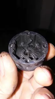

Has this ever happened to anybody i heard about the pins breaking but this to my surprise has never happened or i never seen anything like it so running 6s i lost front wheel drive power i thought my set screw came loose but further investigation lead me to find this Look at pix

Alex you're not alone. I believe I had watched member Thomas P video series on bulletproofing the diff for ideas. I ordered replacement diff gear set AR310436 and TD310475. I added 1 planetary shim behind each gear, and added 1 satellite gear behind 2 of 4 satellite gears(total of 6 satellite shims, that's including the 4 that came in diff). Not tight/not loose, just right now. Again this was for Typhon, diffs may use same gears across brand. Good luck, check out video.

Twice happened....second time was on first run after first diff repair with all new diff gears but after bulletproofing the diff as in the video ive had no problems whatsoever....do it :)
And it was always the bottom gear breaking too...used shims size 5x15x0.3mm and its still running perfect. Oh i put some heavier oil too.

Yea luckily i had a spare from the diff's i replaced im running kraton rear with typhon fromt it seems to be a good combo it just happened bcuz of 6s and thanks for the parts numbers really appreciate it i was looking into getting that xxx475 shims weird to me it was to the front that i lost power w

This happened in my senton last week after running 6s at the track for a few minutes. LHS owner said he'd never seen it happen before.
