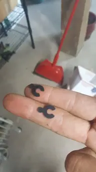

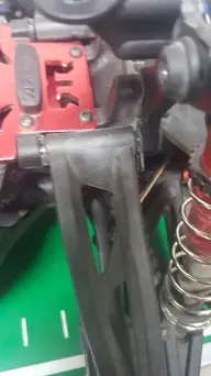

Then you just need to tighten it up it is too loose... maybe your mom or dad can give you a hand its hard to turn when its in the truck. But you have small fingers mine are not so maybe you will have better luck than me... i can barley get in there... if you need to take the red plate off the top thats easy to remove and will give you a little more room... you will need to remove the top two a-arm screw pins too... i put red lines by all that need to be removed to get a bit more room. Pay attention to the shims and where they go on a-arm screw pins. They snap on easily before you tighten the pins back in all the way. Get them started then put shims back in an finish tightening them up.

Then you just need to tighten it up it is too loose... maybe your mom or dad can give you a hand its hard to turn when its in the truck. But you have small fingers mine are not so maybe you will have better luck than me... i can barley get in there... if you need to take the red plate off the top thats easy to remove and will give you a little more room... you will need to remove the top two a-arm screw pins too... i put red lines by all that need to be removed to get a bit more room. Pay attention to the shims and where they go on a-arm screw pins. They snap on easily before you tighten the pins back in all the way. Get them started then put shims back in an finish tightening them up.View attachment 2578 View attachment 2577 View attachment 2577
Thanks so much! I have been camping all weekend, but I will try to do it tomorrow.
