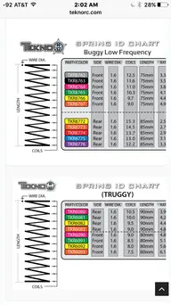

Which ones did you get?
I'll have to double check but I think they are:
FRONTS = TKR8765
REARS = TKR6091
Quick story.
I picked them up a year or so ago from a LHS going out of business. I didn't have a use for them and then forgot I had them when I got my Senton... Then the other day I found them in my bin of RC parts and figured I'd try them on the Senton and they fit perfect! Haha.
The 90mm ones aren't too big for the rears? They look too long, but maybe not.
I just put the 80mm springs on the front of the Senton and they are too long. I have my adjuster all the way up and my front end is sitting way too high. Might put the 80's on the rears and order some 75's for the front
