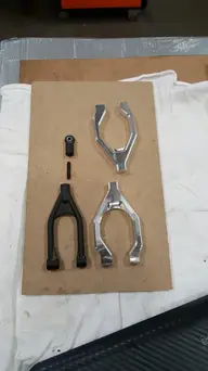

This weekend on the track, the other arm snapped.
Can anybody see if it's due to "bad" plastic or poor driving skills? (there seems to be an air bubble inside the plastic)

You might have just got a bad batch of molded parts in your unit. I have been pretty hard on mine the past month racing indoor off-road and have not broke mine. I have had some pretty tough landings to and my driving is not very good.

made some reinforcements from aluminium and glued them with epoxy.
Let's see how long this setup will hold :-)
It appears some of the parts are good quality and some are bad quality...
Broke a few a-arms in a row, and the last set has held up great so far.
