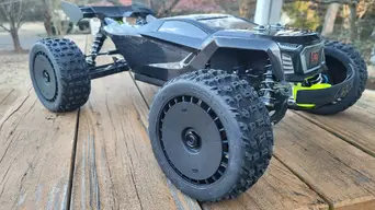

This is my Talion EXB build. Started with a bare, new, EXB Arrma Talion chassis.
All new components. Many are EXB parts. Some from other EXB models. This Talion will have the new V6 Kraton & Notorious front & rear hubs. The towers are Kraton V5 aftermarket style, so, technically not a 'true' Talion. The shocks are all brand new build. Black shock bodies, Kraton springs, TLR X-rings & TLR POM end bushings & caps. The turnbuckles are M5x95 EXB front & rear. EXB camber ends & steering rod ends. Treal aluminum bulkheads. Arrma aluminum 31mm diffs & Mugen diff shims. 70/500/40=F/C/R fluids. Ram Jam 4140 inputs & outdrives.
More progress. Steering bellcrank. Hot Racing one modified. ADU 4mm ackerman modified to accept quad flanged bearings. Two per side. Shimmed in middle. 12.9 shoulder bolts. Just Bash It solid aluminum servo mount.
More progress. Fuze 160a ESC mounted on aluminum ESC plate. More modifications to the dual rear chassis braces. (rev 2.0) Battery & receiver box mounted. Receiver put in. ESC lead & servo lead all routed & power switch mounted & secured.
Power HD servo. GTS-5 Pro low profile servo. 50kg at 8.4v. I'll run it at 6.0v = 38kg & 0.10 transit speed. Very light, still full aluminum case & all metal gears. Brushless & digital.
The Talion OYNX body. This is Tropical Glitz paint. This paint color is 'OVERCAST' but I like the name OYNX.
The finished Talion build will have Katar T tires & a 15t or 16t pinion(maybe a 18t). And some other goodies. Few other pics. I'm not far from complete. Gotta bind the DX6C, and install a custom servo link & set EP. 👌
Awesome looking build :cool:, curious how heavy it is with all that metal.!!
Thanks man! I dunno? I'm gonna weigh it when it's done & see though. Probably too much 😅
