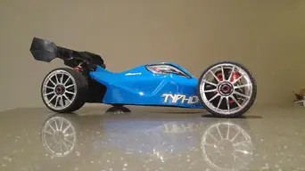

Hey guys, have recently set my typhon up to do some high speeds but i have a few questions.
1. What is the best diff oil combination? Ive currently got fairly heavy in tbe middle (300,000) and 100,000 front and back.
2. Has anybody got recommendations for upgrading the front and rear shocks?
Current setup below.
  • Mamba Monster X
  • Castle Creations 2200kv
  • 6s
  • Savox servo(can't remember model number)
  • 40t spur gear
  • 30t pinion

Thats a very nice looking typhon...
I don't know wich shockupgrade would be ok but make sure that you put some lightweight oil in them for speedruns...makes the car a bit better to handle at high speeds. And don't use very stiff springs on a speedrun.
