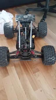

Hi there, I have two carbon braces installed just the way you described in the beginning and it works perfectly! My experience is that they have to be capable of handling both forces push and pull. In the beginning I had the carbon rods glued in with silicone but if you land on the chassis on a hill top it would rip the braces out on pull. Fixed it with epoxy and additional screws. Never had an issues since then and I bash HARD.
