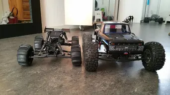

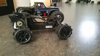

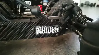

Had a used Fury chassi in almost NIB condition, so why not do something with it?...the regular Raider have the same wheelbase as the Granite. Got some 2mm Carbonfibreplates and started to
work..il be using
Leopard 2845 - 4pole 4500motor
Castle SCT Pro esc to handle some power might get a HW 60A insted
Stock TT ACE servo
2-3s lipo 1700-2200mah
Proline Slingshots for MiniErevo
Enjoy

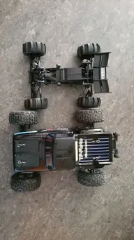

This is just a thought...planning to get Hobbywings simple 540 3000rpm sensorless motor and a HW80A esc...any idea what that motor can draw in amp?...cant be much in this light 2wd car...will use 45A packs propably higher burst..can it work?
Operator7G
69
47
Houston, TX
Wouldn't the Proline Mohawks be better on the front for providing directional assistance during those precious moments when the front end actually makes contact with the ground?
