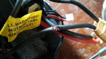

Hello all! I just need to share a rather serious problem I had with my Typhon. I was running my almost new buggy the other day, when suddenly it stopped dead. I had steering control, but no forward or reverse. Inside, I popped the body, and to my great surprise, my battery cables had slipped into the small opening on the main diff gear housing, and were shredded to bare wire, and shorted out my buggy!
Off to my RC store. Luckily, my electronics survived, but my $60 baterry was puffed and fried!! The exposed wires were repaired using liquid electrical tape. So, I'm up and running again, minus $60. I don't no if all Arrma trucks have this potential problem, but Typhon 6s owners should check for this situation. I don't understand why the diff housing doesn't extend further, which would eliminate this problem. Race and learn I guess!
<pAuL>
same happened on my kraton just when i switched batteries once, but didnt notice until after the run, the spur cut through almost the whole battery cable lol, went to my lhs and they shortened the cables and resoldered :)
most mistakes will only happen once ;)

Same thing here, but with my Senton I got too excited and tossed a 4s in an just ran it without doing a good check over and I didn't notice that from the factory the jumper wire was pinched between the battery tray and the spur so I got 15 feet before it cut the wire.. no damage done otherwise.
I use a simple zip tie to the top plate of the center diff and ive never had an issue with my wires entering the gears. Also eliminated the factory dual battery get-up for single 4s batteries and that tied things up a bit for me as well.
